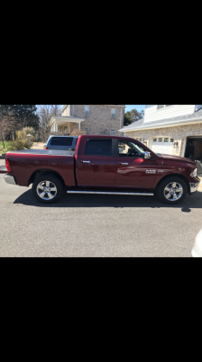

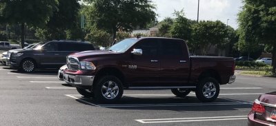

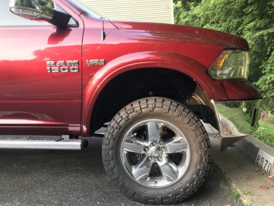

My bilsteins are also set low right now (.7” lift). So pretty much stock height for the front assembly.
I love the procomp kit and it rides great and gave it just enough of an adjustment in ride height for what I was looking for.
Imo- going with 0” on the front Bilsteins will give the truck just a little too much rake. I wish mine were at 2.1” but oh well I can live with the .7” for now.
As for the 325/60 tires I think they’ll be perfect as well. They’re a hair taller than 35s but wider than 12.5s so they’ll look great as well.
Here’s a pic of mine if you want a rough look at a procomp with front struts set close to factory height and 35s.....
I also incl a pic of it stock bc sometimes you have to be reminded just how ridiculously low these 1500s come from the factory. Bc I swear I can look at my truck after a few months and feel like it’s tiny again lol
