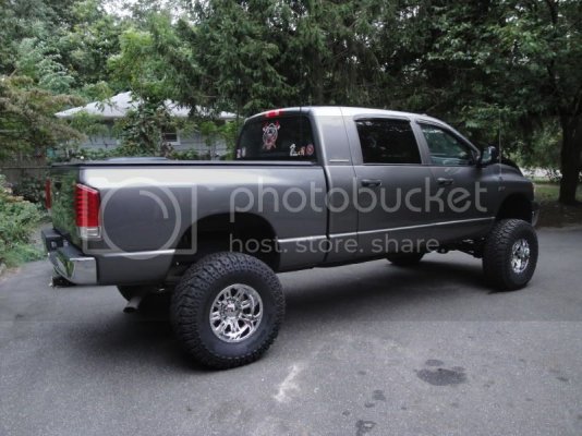

gonna be really pissed when you see this..........
Well, I finally got the rest of the lift installed in my Megacab this weekend (had a 4.5" Rancho suspension, now I added a 3" bodylift) and installed my new 37" **** Cepek FC-II's. Whatcha think?
I'll be damned.......looks like a body lifted MEGA!
I asked him for the part number and stuff.
0212353
Vendor
Jun 29, 2010
26,460
2,029
Florissant, MO
2x 5.7L & 6.2L
1500 vs 2500 on a mega...........differences are only spring rates right?
0212353
Vendor
Jun 29, 2010
26,460
2,029
Florissant, MO
2x 5.7L & 6.2L
Body lift is a Performance Accessories (part# 60183) Install was fairly easy. I did it by myself in about 1-1/2 days (taking my time) I don't have tow hooks on the front of my truck so I didn't have to cut up the factory front bumper brackets, the kit was 100% bolt-on (ok 97-1/2%, I did have to weld in the crush blocks). Just take your time and follow the instructions. I just checked off each step as I did them. Oh yeah, There was one glitch. The fuel fill vent hose!!! the kit showed it as being a regular fuel hose and our trucks have that semi-rigid plastic line with the quick-disconnect fittings. I just removed the whole line and replaced it with 1/4" (I think) fuel line with hose clamps.
there ya go!
