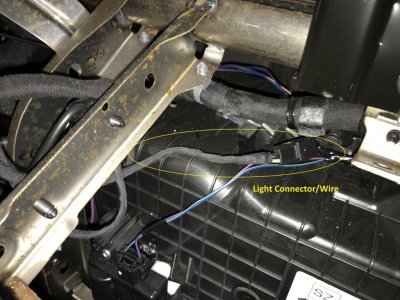

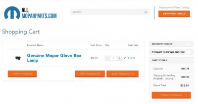

I did the upper glove box install a couple of weeks ago. I did get the box from All Mopar Parts. I also wanted the light but guess what's wrong with that picture:
More to ship than the light is worth? WTF is up with that. I did find it on ebay
https://www.ebay.com/itm/OEM-Glove-Box-Lamp-Light-Bulb-and-Switch-4565022-Fits-DODGE-RAM-CHRYSLER-JEEP/372487778490?ssPageName=STRK:MEBIDX:IT&_trksid=p2060353.m2749.l2649

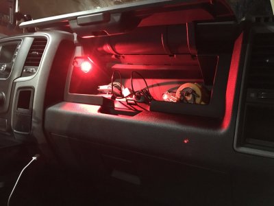

Cost with tax about $12 and shipping was free. It did take a couple of weeks since it comes from China, I guess, but the vendor is reliable and you get updates during the process. I installed it today and it works perfectly. I even replaced the bulb with a red LED I had laying around to give it a different look. I found the connector wire tucked in behind the metal brace on the left when you remove the original tray. You have to feed it over this brace to get the length to plug it into the light in the new glove box tray.
Hope this helps
Pete
PS. I did figure out that the light must be on a timer. If you leave the glove box door open, after a minute or so the light goes off and won't come on even if you play with the switch. I had the passenger door open throughout this. But if I closed and opened the truck door again or switched the ignition on and off, the light came back on. Security I guess in case you leave the glove box door open and then walk away from the truck. Makes sense.

I like the red light . I am going to get a LED light to see if I get more light
