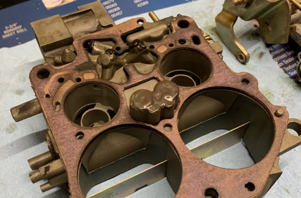

Also regarding the QuadraJet, it might be worth taking it apart anyway and seeing if the well plugs in the bottom have been sealed up.
Those are just tacked in with a bit of pot metal and as they age, they can leak fuel out of the bowl and into the engine, so it floods the motor a bit and takes a moment to get fuel back up into the bowl. A bit of JB Weld tactically applied solves that. I had my QuadraJet rebuilt by a fellow I work with who used to run them religiously in the 70s and 80s, so he was able to point out all the intricacies there.
