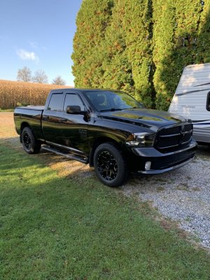

Now, question is, what should I be running for air pressure in these? Sidewall says 80 lbs max. They are Nankang AT-5 Conquerer’s. E rated, 10 ply.

Good looking truck......nice choice on wheels,....not sure on psi.....I run about 44psi in mine & rides great

Looks nice, 80 PSI, ahhhh, that is the Max under Max weight,. No way. See Johnny MAc post above...

Yeah I just bounced around the air pressure question too. Mine say 80 @ 3900. Way to high if your not loaded. I'm running 45 but think I might go somewhere between that and 35. Think about what you load on the daily and adjust from there. If your like me and don't really haul anywhere between 35 / 45 should do it.

Thanks guys. I was gonna bump it up to 40 and then add some for this.

Been running at 40 psi. Rides better than the stock tires. Seems to eat up small bumps better.
Assuming you did an LT275 and not a P metric. According to the TRA tables
Front needs 50psi to make 2680lb per tire for a total of 5260 which is what my 18 front axle is.
Rear needs 40(2280lb) to 45(2465lb) empty. You might even be able to go to 35(2080lb). Since my 18 is a DRW I don't have real weights for a SRW. I would run 5-10 psi above the above pressure so you don't need to watch pressure change due to temperature getting colder as tire pressure drops 1 psi per 12F temp change.
Your TPMS will trigger below 65(3195LB) rear if you have a 2500.

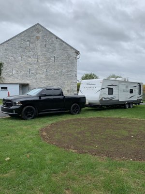

I have a 1500, as you can tell from the pictures. I ran my previous set of stock tires at 35 psi. Which is what was recommended by the dealer as I asked them when I had the tires rotated. They wore evenly, but I tow the above pictured camper, so they wore quickly in my opinion. I upgraded to LT tires yes. When towing my camper, I will probably bump up to 50 and see what it’s like.
