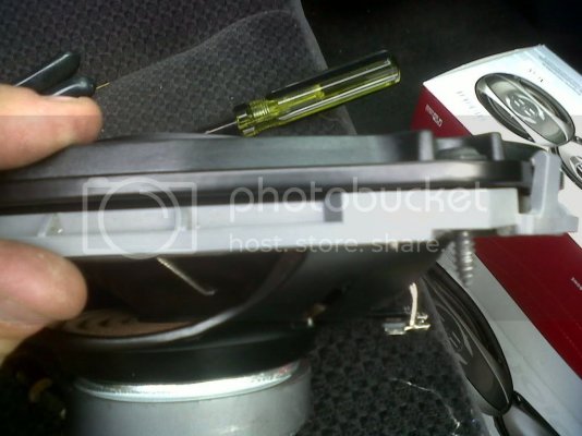

I got some 6.5" Alpine Type G speakers. They aren't the greatest but they are better than stock. I know they are too deep to mount without an "adapter" (read a cut piece of plywood/mdf). I know some folks have used Type Rs in the doors. How thick a piece of plywood/mdf do I need to make me an adapter?

I know I'm a 2nd gen but when I pit my 6x9's in my door they were a 1/2 inch too deep. I just went to the hardware store and got some nuts a 1/2 inch thick and some longer screws with similar threads and Mine fit great. Less cutting and what not. Just a thought.

i used 3/4 that i had lying around. i bought some for my 05 that were about 1/4" thick. there is plenty of room i plan on bringing mine out more to be closer to the grill

you can move about 3/4" out toward to the door. You can also mount a 2.5" deep speaker without needing an adapter. I didnt use an adapter with my Alpine Type X and they fit fine.

I bought some 1/4" figuring if I needed more I could double up on it. 1/4" was enough to make sure I miss the window and all. Now I have a new problem....
