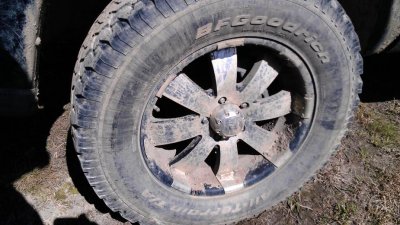

Forgot that I hauled this truck in last year. Owner hit a Moose, had no insurance, so my Boss bought it off of him. It could be rebuildable if someone wanted too I suppose. But anyway, it is an 04 or 05 1500 with 20" Ultra Mako wheels.
Now I wasn't going to go 20", but I basically paid 25 dollars a wheel lol. Have to pick out some tires to go with em now. Need quiet highway ride that will have decent trail manners. No mudding really, too annoying to clean off.
I will probably refinish them as he thinks they need it, hard to tell with all the mud.

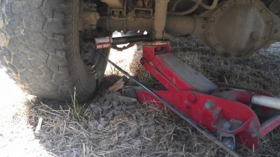

So I went down to the boneyard today to remove the wheels from the truck. One of them put up a serious fight, I don't think the owner ever rotated the tires, because it was stuck on hard. Aluminum wheels on steel rotors causes some nasty corrosion if left unchecked due to dissimilar metals. So let this be a lesson to you if you never pull your wheels off lol.
I sourced a gear driven bottle jack from another truck in the yard to finally pop it off.

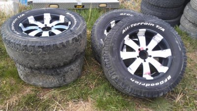

Took them into the shop and pressure washed them and used some power spray clean, and then finally hit it with some acid wash to get all the grime off of them. The clearcoat was badly damaged from the muddy lease roads he was driving on. The inside of one rim was gouged, looks like he dropped a ball joint, or sheared studs at one point and the rotor rode the inside of the rim. Oddly that is the only one that was still holding air, so I think the rim is fine, but I will know for sure when I get the tires off the rims on monday. Our machine only goes up to 18" so I will have to take it to a shop monday to get the tires stripped so I can refinish these rims.
What I am going to do is strip that clear off of them, and then acid wash them which will give them a satin finish, and then respray the black parts, and reclear them.

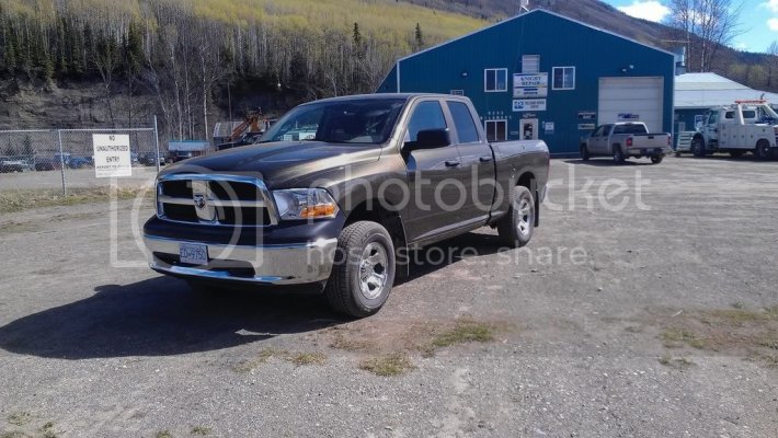

Got the rest of the Procomp Nitro level lift kit installed today. Very happy with the results, rides like stock.
This was stock ride height
With 2.5 inch spacer up front stock rear
and finally 2.5 inch front, 1.5 inch rear
Test fitting the new wheels. Funny, the lugnuts that came from the 04 ram, won't thread onto my studs. They must have changed the thread count or something. Kind of annoying.
