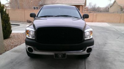

Im New to owning a dodge ram and never have had a grill be attached to the hood, and I hate the current grill that is on it, how do you replace the grill on it? (Don't judge my Raiders plate. I know they suck but oh well) uploadfromtaptalk1391740637564.jpg

If I remember correctly from my '07 there are 4-6 screws from the back bracket to the hood that need to be removed then the grille assembly will just pull off, and there were 4-6 screws holding the grille to the bracket. If yours is a one piece unit then you'd need to replace the entire thing with either the oem grille or with another one piece unit.
