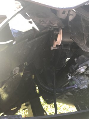

That’s the grill shutter servo with the screw trick. My shutters are fully removed. No cel. Just zip tied the servo out of the way
