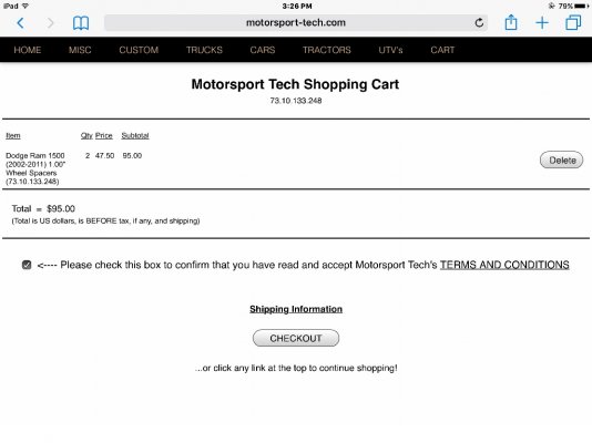

I've looked on Motorsports Tech website but I am not seeing 10mm spacers for my 2011 Ram BigHorn. Is it possible that it's the 1" spacer as listed here ?cf7d06a94bc126f8db42a8c8c8f9dadb.jpg
DRKNESS falls
It's under custom spacers. They have to make it.

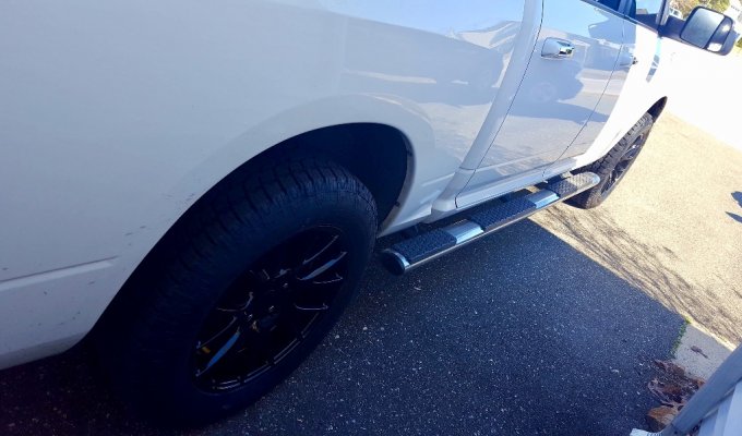

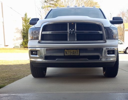

Lol, yes I ended up finding it and have a set of (4) 10mm being made for the truck just in case. It's clearing in front, but I can't run my finger between the tire and the strut (?).4108290374cad453dbbb1bfd33b06085.jpg

Looks awesome, I just ordered my wheels, tires, lug nuts, and tpms sensors today. Everything is shipping today except the wheels.....go figure. Can't wait to see what 24x9.5 looks like [emoji7]
