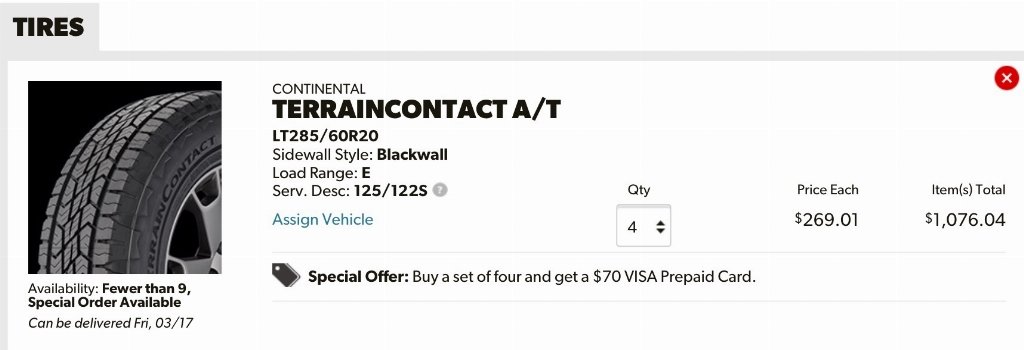

With my new wheels being 20x9 with a 25.4 offset and my Bilstein set at 2.1, can I go with a 285/60 as opposed to my current 275/60 ? These are the ines that I am looking at.52edd47060c91aa4e0cd44c5eefebb5b.jpg

Yes, you'll be able to run 285/60/20's on 20x9 +25 offset wheels. It's going to be very close, but they should fit.

I've decided to stick with 275/60 and go with either Toyo Open Country A/T or those new Continental A/T..

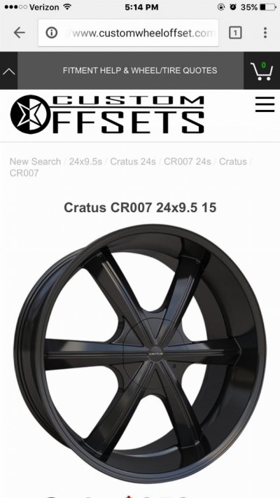

I know it's only 4mm different from my stocks. I was looking at getting +25 22x10 wheels and really didn't want to fork out the cash for everything and then still have to buy spacers for almost 200$ I decided on a 24x9.5 with +15, shouldn't need spacers this way.

No I'm 4x4, with the wheel and tire setup I'll be almost identical to my stocks in height and should only be about 15mm closer to the Upper control arm. I don't think I'll need spacers here.

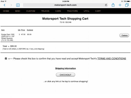

I've looked on Motorsports Tech website but I am not seeing 10mm spacers for my 2011 Ram BigHorn. Is it possible that it's the 1" spacer as listed here ?cf7d06a94bc126f8db42a8c8c8f9dadb.jpg
