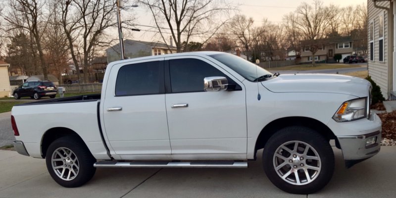

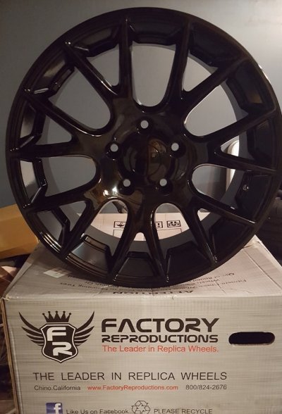

I own a set of 20x9 ET 25 Hellcat wheels. I want to put LT295/60 tires on. I'm currently running Bilsteins on all (4) corners with the fronts set at 2.1. Is this doable without spacers, or should I stick with an LT 275/60 tire ? I don't off road or use it in the woods or beach, yet I want a slight aggressive look with these wheels. What say yee folks ?f53103bbaff33ca13105b68f0bd54f4d.jpg38653d5fd809d53502bbf66c64694c3e.jpg
What is the offset on those wheels. In the other thread I figured you were talking about stock wheels

Will do, the good part is I only paid $800 total for these wheels so if it doesn't work no loss. Also if it doesn't work, I've already contacted a company about doing the wheels that are currently on there in " black chrome " which is what I really wanted.
As quietpeen stated, that setup won't work without spacers. You'd need to either stick with a 275 wide tire or add a set of 10mm hub centric spacers from Motorsport Tech.

^^^. Just the person whom I was hoping would join in with his knowledge. Knowing that I don't really want spacers, I can accept sticking with a 275 sized tire. I just want a A/T look without being over the top. Hopefully Toyo will have something that suits that in a 275/60 fitment. :)
