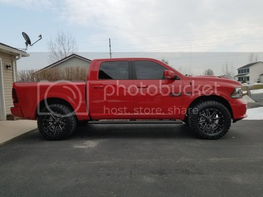

2.1 setting for level, right?
Not sure, I added rear springs to mine so mine still isn't level. Most guys though have done 2.1 to be level.
quietpeen
Jul 14, 2010
25,443
3,913
2021 TRX
Hellcat
generally 2.1 leaves some rake. My truck basically still has 1" of rake and i'm at 2.1
daveray9
Oct 22, 2015
1,698
588
Can you notice it though? Can we get a pic from the side on a level surface?

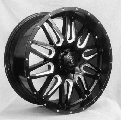

Thinking of these 20x9 for my forest green 1500.
Just hoping for some feedback from those with the v6. If there mpg or acceleration suffered a lot due to the heavier wheels/tires. If so hopefully a cai or flowmaster 44 can help. Level it out.
