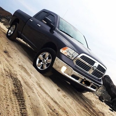

Hey all,
It's about that time I do tires and wheels. I read through everything, great thread. I have a '16 1500 Big Horn 5.7 4x4 on 20" chrome clads. Put a 2.5" spacer lift in the front at 2k miles and now at 20k miles. Didn't do any lift in the rear. Looking for some info and opinions on which direction I should go. During summer I beach drive usually once a week as an FYI I know this matters in some cases.
On page 9, "bubbasneed" posted pictures of his Ram that is on 2.1 bils, 20x10 -19 wheels, and 33x12.5x20 tires. I like the look a lot and he said he was happy with it, but I am wondering if I can go with a bit bigger tire without having any issues. (Every inch counts right?) Does the .4" difference in spacer/bils make any difference in clearance? I'm nervous of running 35's because I know some people have fitment issues but I know that is a case by case issue so that is why I decided to ask for some help.
With my truck and my level kit, what am I safest to run with mostly highly miles and some beach miles? 33's, 34's, 35's? And on what size wheel? Ideally I'd like to achieve as much height as possible, poke out from the fenders a little bit to give it a meaner look and stance.
Whatever the sizes are, I'd like a chrome faced wheel with a black lip, and knobbier All Terrain tire that are decent for highway. If anyone has recommendations that won't break the bank please let me know.
Thank you in advance.

To simplify, how can I fit 35s on a '16 Big Horn Quad Cab with a 2.5" body lift comfortably with a -19/-24 offset?

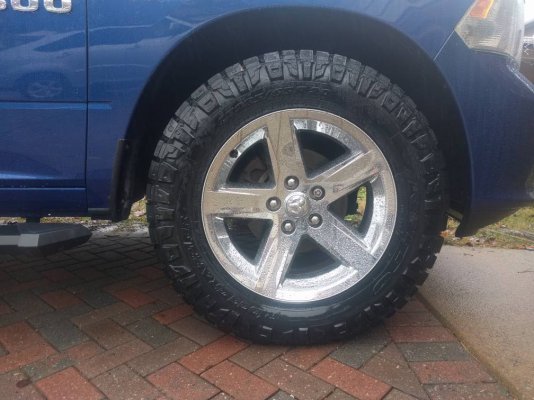

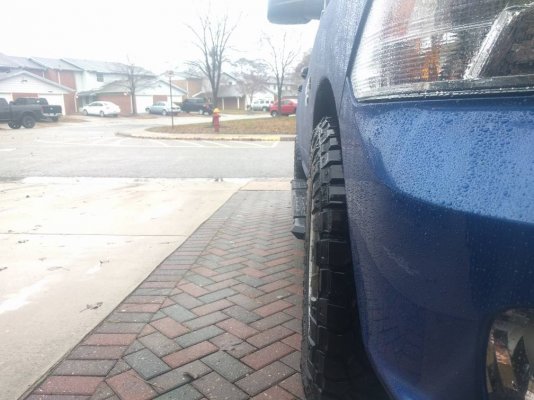

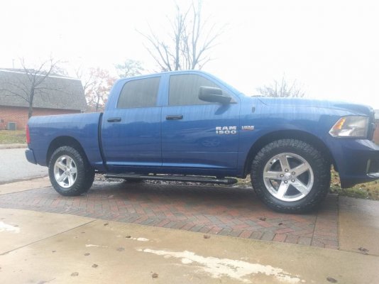

Nitto ridge grapplers 285/65r20 on stock chrome clad and stick suspension no rub and loving them1337e2255dd9580b107ca5e2161c1cc6.jpgd6ab777f9c4f782f61a510173dba6ee2.jpg5da2ee2e344c8ec80127f3274edd5e7e.jpg
Sent from my Nexus 5X using Tapatalk

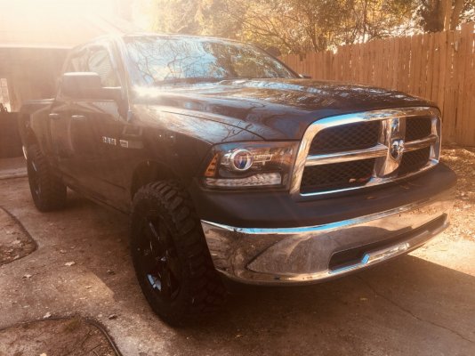

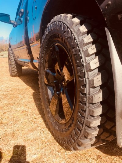

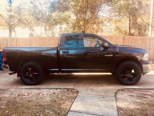

2010
I posted this info elsewhere but I doubt anyone has seen it. I have a level front and stock 20’s on a 2010 with 1” spacers. I went with 35x12.5x20 firestone mt/2’s. Rides awesome a small amount of rubbing at full lock but it is purely on my plastic inner fender. Look is a little stuffed but I work out of the truck so reaching over the side is kinda important.
Amazingly smooth and quiet tire. About as loud as my terra grappler g2’s on my jeep. Just got em so I’m sure they will get a little louder but very impressed.

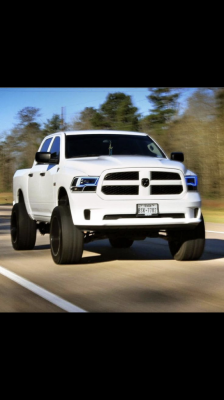

9590DBE1-9C86-4DA8-B28A-A3B5C3A3AE0E.png I’m new here and have a question. I’ve got a 2010 1500 quad cab that’s been lowered with a 2/4 drop on 24’s. I’m now wanting to go the other way. I need to know what offset I’ll need to go with in order to get the wheels 3-4 inches past the fender well if I’m using a 22 inch rim. I spoke with someone at a shop and they suggested a Rough Country 6 inch lift and going with a 22x14 with a -76 offset. This is the look I’m trying to achieve. Also would I need to go with a 6 inch lift or would 4 be enough. Can anyone tell just by looking what this truck has?

I highly doubt it would rub. Mine doesn’t rub much with 35’s I think If I just zip tie the wheel well plastic liner in a little tighter it will fix that issue.

View attachment 118320 I’m new here and have a question. I’ve got a 2010 1500 quad cab that’s been lowered with a 2/4 drop on 24’s. I’m now wanting to go the other way. I need to know what offset I’ll need to go with in order to get the wheels 3-4 inches past the fender well if I’m using a 22 inch rim. I spoke with someone at a shop and they suggested a Rough Country 6 inch lift and going with a 22x14 with a -76 offset. This is the look I’m trying to achieve. Also would I need to go with a 6 inch lift or would 4 be enough. Can anyone tell just by looking what this truck has?
If you're wanting the look imaged and 3"-4" past the body stance, a 22x12 -44 will get you there. It's up to you, but you cant fit that in on level with 0 trimming. Hell, you can fit that stock height with no trimming.
A 20x12 or in your case or 22x12 wheel with a 305/50/20 / 305/50/22 tire fits a 4th get Ram stock height with no rubbing. Don't be scared
