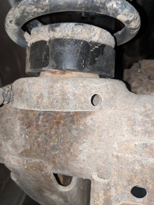

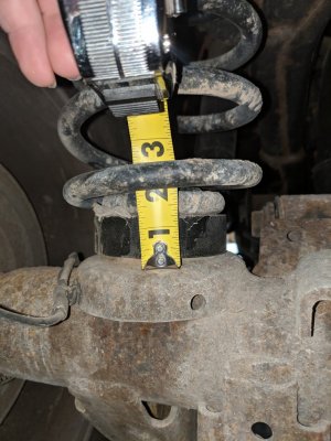

Thanks for the write up, I just did the 5100 on 2.8 and a spacer 1" in the back. I'm wonder what you guys think of this spacer, not sure it's of good quality.

Im pretty sure the spacer is supposed to go on the top side of spring.
LouieBlues
Senior Moment
Sep 23, 2018
369
732
North Jawga
2017 Sport 4x4 SCSB
They make spacers to go top and bottom. the one in the pic is made to go on the bottom as shown.
Nothing wrong with it, but the top pic does look like its not seated correctly.
