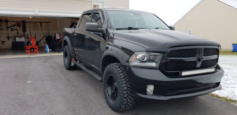

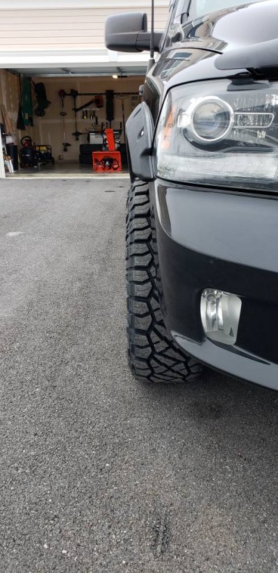

That's pretty sharp, Apiazza! Can I ask what size your wheels are/offset? Any spacers needed? Side note- what kind of antenna is that?? Whenever I go to the carwash I think mine's gonna get ripped off!!
Wheels are 17x9 -12 raceline shift wheels with ridge grapplers. Definitely no spacers in this case. The 0 offset would look good with small or no flares. Mine are very wide and the -12 brings tires to about flush. I would probably consider going -6 if I was to do it all over again, but I'm still very happy with the overall package. Obviously all personal preference. The antenna is from Amazon. Rydonair is the maker. Inexpensive and not a major reduction in reception. They recommend removing it for the car wash.

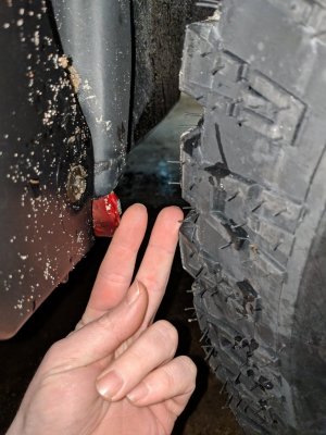

So I'm running Bilstein 6112s at 2.3" front and their 1" rear coils. Before I put oem 20s on I ran 315 70 17s with 1.5" wheel spacers and no rubbing, including offroad. There was a SLIGHT kiss on the one wheel liner that I had to search hsrd to find, heated the liner with a torch and mushed it back and all was good. With the 1.5" spacers I was effectively at -12 offset. It was close, but never rubbed. That being said my tires did hit my fender flares up top when I jumped my truck, so just don't jump it and you'll be good [emoji16]1f60f6ca4a9740a13a9772271ffb4133.jpg
