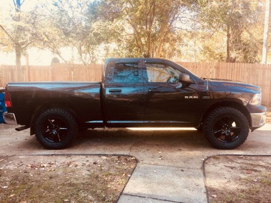

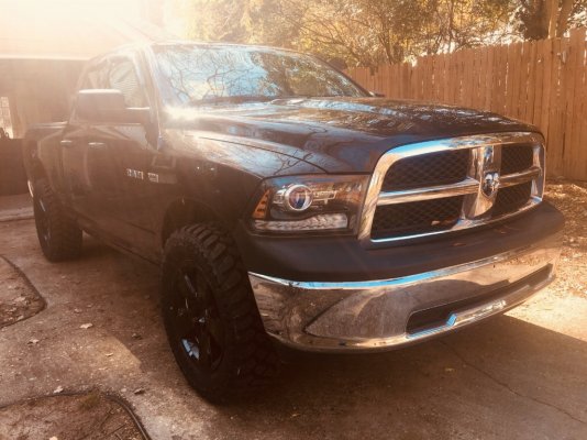

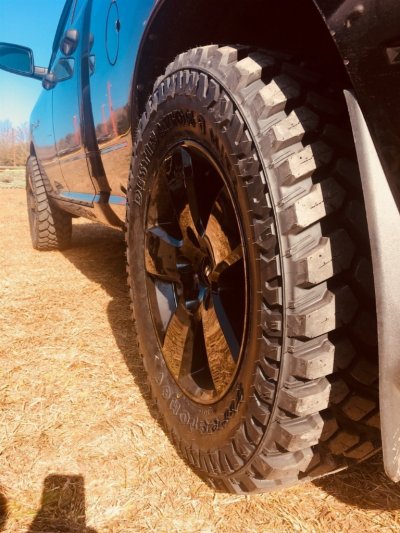

I posted this info elsewhere but I doubt anyone has seen it. I have a level front and stock 20’s on a 2010 with 1” spacers. I went with 35x12.5x20 firestone mt/2’s. Rides awesome a small amount of rubbing at full lock but it is purely on my plastic inner fender. Look is a little stuffed but I work out of the truck so reaching over the side is kinda important.
Amazingly smooth and quiet tire. About as loud as my terra grappler g2’s on my jeep. Just got em so I’m sure they will get a little louder but very impressed.
how do you like these tires? how is the wearing on them going?
Rugged
Jan 29, 2017
145
210
2010
Tires are still awesome. Wearing pretty good from what I can tell. I only have about 6000 on them. They don’t disappoint. Had them in pretty much everything and they have no issues.
