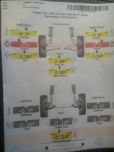

Find any competent alignment shop and ask them to set your aligment to this specs.

So I finally had this done - they couldn't quite get to 5* as my eccentrics were close to being maxed out on the lowers so it would have thrown those out of whack... at least that's what they told me. But did get to 3.8 which was enough to clear the minor rub on the liner :waytogo: - thanks!

Lazy phockers is what they are :) I got mine aligned again couple of days ago. Watched the dude literally do everything in about 15 min, 4.5* driver, 5.0* passenger caster, 0* camber, 0.05* toe on both sides. Found out I need at least 4.7* on the driver side for the 37’s not to rub. I have a very mild rubbing now going in reverse turning. Something I didn’t t have with 4.7 caster on that side. I’ll get fixed next time. I go through alignments like oil changes haha.
