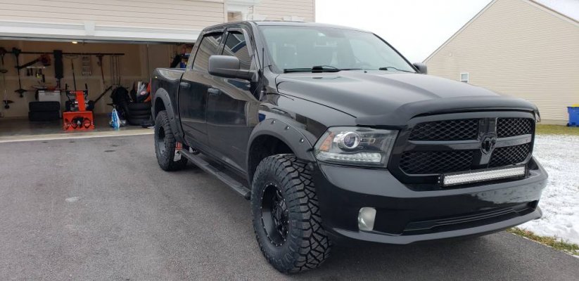

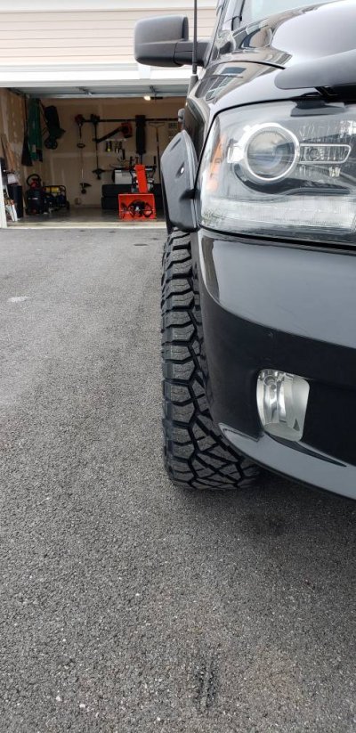

I have bils at 2.8 with a .75" rear spacer. 35x12.5 on 17x9 -12 wheels. I have no contact at all. At 2.1 you might not clear at -12 but I would think you would at -6. I can't say for sure though. Probably really close. 7a0e97316cabdb883b008419ec062815.jpg260445a99e2f04c3359b4643fe76bd5f.jpg

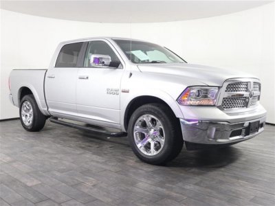

Just joined today and this is a very informative forum.
I'm having Bilsteins installed to level my 2017 Lariat 1500 4x4 on Tuesday.
I plan on keeping my factory chrome 20" wheels and am beating myself up trying to decide what size tire to go with. I'd rather not run spacers. I don't want too much tire and don't want too little.
Is there a gallery of leveled trucks by chance with tire sizes ?d9f95143f7604f75a3b0d39bff7a73ed.jpg
JB1
Nov 3, 2011
8,366
7,542
Houston, Texas
Is there a gallery of leveled trucks by chance with tire sizes ?View attachment 172293
Welcome to the Ramforum
What height are you planning on setting the Bilsteins at?
Any rear lift?
Lots of pics here:
https://www.ramforum.com/threads/alright-guys-bilsteins-post-your-pics.79370/

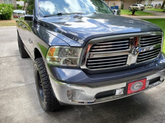

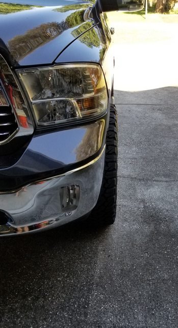

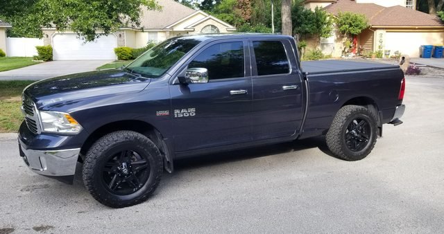

Offset is making my head spin... seems like most specs are in increments of 6, ie -12, -18, -24, etc.
Currently I have American Outlaws (Discount Tire Brand) 20x9 with 35x12.50 BFG AT's. They are +10 offset. They stick out a bit, but not much I guess - although I do notice the fronts stick out a bit more than the rear. I have a bit of rub turning left, with the outer edge of the tire catching the liner - but none turning right. I can trim a few inches of the fender liner I'm sure, but was curious about spacers since my rears appear tucked in more compared to the fronts.
If I added a 10mm spacer as an example, would it push them out further, or tuck them in more?
olyelr
Nov 18, 2018
5,608
4,631
Kewadin MI
It would push them out more, making them rub worse.
78Staff
US Navy Veteran
Aug 3, 2018
976
554
NE Florida
OK, that is what I thought,but wanted to be sure. So no spacers on the front then :). Might still look at some on the rear to bring them out to look more "even" with the fronts - haven't decided.
These rims aren't that old, but if I do change down the road then I need to look at less offset ie 0 or even negative, based on the OP it appears...
