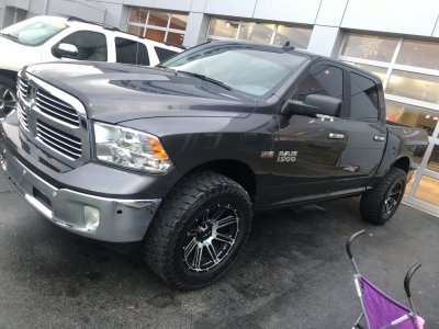

I think I’m clear but I just want to verify. I’ll be installing the Maxtrac leveling coils and shocks on Monday and having 35x11.5 ridge grapplers installed on original Laramie wheels. I shouldn’t rub much if any right?

I believe you are safe, especially with the 11.5's. That's what size my next set will be.

You were right. Thank you for help! I’ve got about ½”-¾” of room between the tire and control arm. 086cd884ef084dd405a31b7a01665562.jpg
Nice! I been looking for pics of 35s on these specific stock wheels. Debating level or 4in lift.... Any pics of other angles? Any spacers?
THanks and Nice truck!

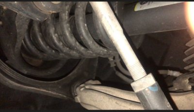

Hey all, I recently bought my 17 about a month ago, it came with 35x12.5s on it, from previous research I was under the impression you couldn’t fit 35s on them with out a level, well I can’t see spacers and it’s still stock front shocks and I’m rubbing plastics on turns.. so my solution after a lot of reading and research is bilstien 5100. Now I measured my truck on “roughly” level ground and I have maybe 3/4 -1” difference between front and rear on both sides. Which brings me to my question.. will the new shocks over level me where it looks like I’m pulling a invisible trailer XD should invest in blocks or new rear shocks as well ? Or will it hardly be noticible. I’m just looking to get rid of the rub. Thanks for your help in advance. Here’s how my truck sits currently
crazykid1994
Sep 21, 2013
5,063
5,064
Florida
Post pictures of your front struts. Most trucks are 2-3” different front to rear. Sounds like someone may have installed something in there that you might not be catching right off the bat

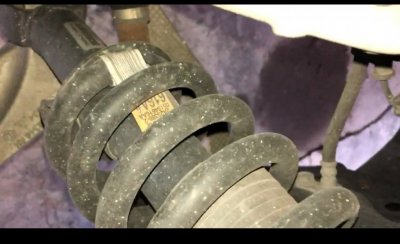

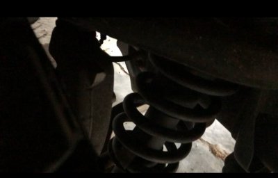

CodyB
Mar 2, 2020
10
Kentucky
EB2D8955-8ED6-4DF1-9C9A-F9129848A09D.jpeg 28BAA497-F305-4788-AB9A-04C84E3E227B.jpeg
Very possible im not seeing the spacers, it is tight up there. Here the best one I got when I was using my phone for a flash light.

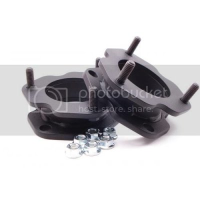

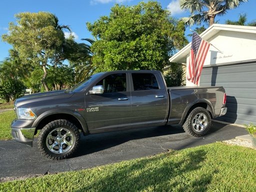

Leveling spacers are installed on top of your factory strut to raise the front end of your truck. Typically there are two heights that guys will use; 2” and 2.5”. The amount of lift you will get from them is fairly straight forward; it’s whatever the spacer size is listed as. Now keep in mind the spacer itself will not actually measure the same as the lift height it provides. Spacers are used in conjunction with rotating the strut 180 degrees and giving it a steeper angle to achieve the front end lift.
There is only one advantage to using spacers over Bilsteins in my opinion….. cost. Spacers are obviously cheaper than Bilsteins but you have to remember what you are getting in comparison. Yes you will achieve your front end lift but you are also missing out on things and putting your front end at slightly more risk at the same time.
Here are the cons of using spacers rather than Bilsteins:
• You are not replacing the front shocks (struts). Therefore your ride quality will be the same if not worse than stock. The reason it could be worse is because now the strut is being used at a different angle (therefore a different rate) than what it was tuned for. Are most people going to notice that difference? No, I’m just giving you the heads up that it is a possibility.
• Because the spacer is simply installed on top of the factory strut the entire strut assembly is now too long when fully extended. This will put your control arms and CV shafts at steeper angles which can be harder on CV shaft joints, ball joints, and tie-rod ends. Again, not everyone will notice this problem. If you’re only driving your truck on the street and never going somewhere that your suspension will be fully extended you having nothing to worry about.
• Spacers limit the amount of upward suspension travel which can lead to bottoming out​
All that being said, tons of guys will be able to run standard spacers with no issues at all. I ran them on my 1500 for 8 months with no issues whatsoever. However I do regret not buying the Bilsteins from the get-go because I did end up buying them when I lifted it (and was very impressed with them).
As far as I’m concerned, if you’re buying spacers you better be buying them from Hell Bent Steel. They have the best price on them. If you’re looking at getting them from someone else (where you’ll be spending more money) you might as well pony up the little bit of extra cash, do yourself a favor and buy the Bilsteins.
