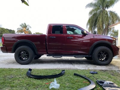

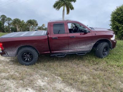

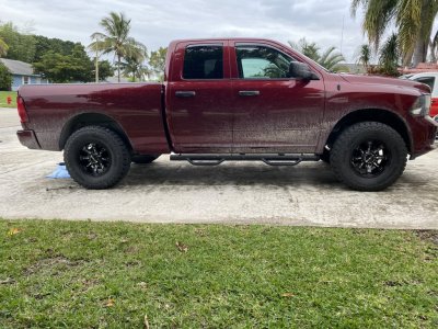

Figured I’d share this here for future reference. Running eibach springs with Bilstein 5100. 3” lift with 1.25” rear lift. 305/70r18 (35x12.5) Mickey Thompson atz p3 on a 18x9 -12 wheel fits with no noticeable rubbing so far. Although the spare does not fit in the factory location

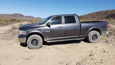

Great thread! I have a question and I may have overlooked it in this thread. But I want to run a 35x12.50r20 on the stock rim i will be doing a leveling kit 3 in the front 2 in the rear. What size spacer do you think I'll need to use? I was thinking a 1.5in hub centric spacer. Any suggestions would be greatly appreciated.
Oliver_Closov
Sep 17, 2016
43
19
SoCal
2016 Ram 1500 Laramie Crew Cab 4X4 w/6.4ft bed
I think it will fit as is. I have 2.6" lift in front and 1.5" Icon springs in rear. I still have 33" on it, but everyone I've talked to is certain 35s would fit without rubbing

I may try that first and just have a set of 1/4 in spacers just incase.

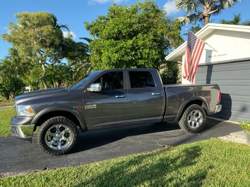

I am on a slight incline in this photo, but I feel like there is plenty of room, although my tires are more narrow than yours.
