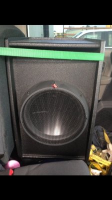

Im running a rockford fosgate t1000 mono block amp 4ga wiring kit. Rockford fosgate t1 12" 2ohm sub. I think im going to do the big 3 upgrade for now and see how that works out but i will eventully go with dual batterys and bigger alternator

For that there really is no reason to spend the money on dual bats and an alt. I that 2000w in my truck right now and rarely get the lights to dim. Now if you step up to a mono amp over 1500w at 1 ohm and are burping then I would look into the extra bat but if you are just playing music there is really no way you should be getting huge voltage drops to warrant the money in an upgrade like that. Of course im always building my system to be bigger and better so if you are like me yeah do it for sure.
