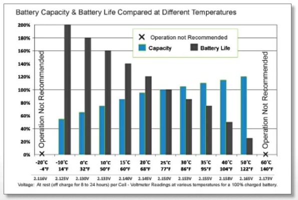

In theory it should last longer in cold regions, take advantage of the longer battery life by having more capacity in the bank. Plus, for interstate the h8 for some reason was even cheaper, just need to make it sit in the tray, no reason not to go h8 imo, huge benefit in cold states. If you think of capacity as chips in a bank account, you have more chips to lose thus longer lifespan as far as capacity goes, is the theory. In warm states, maybe not worth even messing with it, just stay with h7 because you already have a low lifespan.
Understand the balance of batteries, cold = long lifespan less capacity, hot = less lifespan more capacity.

The H7 is ok, but marginal here in flyover land weather. Also marginal if you added a bunch of electronic gizmos to your truck.
I live where "Operation Not Recommended" weather occurred for the last 21 days straight - literally:

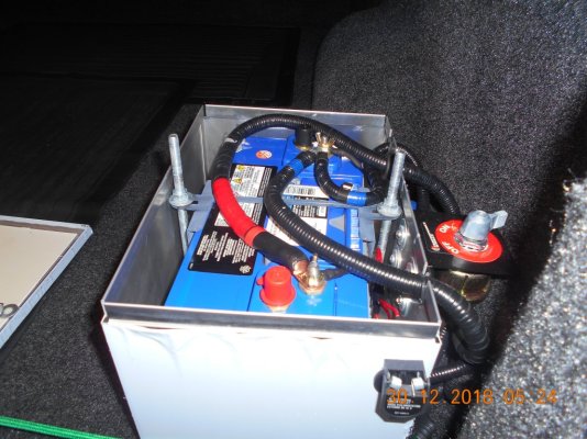

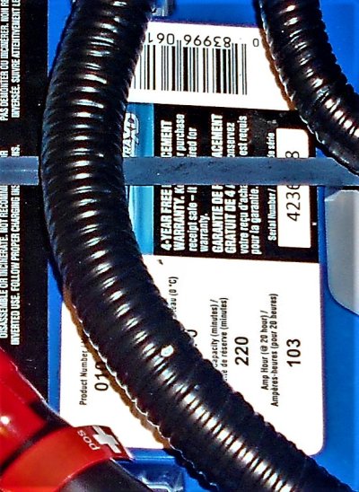

Don't worry Sherms always got some Doom Sayer news. I've been running a huge group 31 for many years in my truck,and it's also relocated to the box of the truck,and the alternator works perfectly fine at keeping it charged.
If anybody would of had issues with the alternator it would of been me,as the battery is a good 15 ft from where it originally sat,and is fed using heavy duty welding cables,plus runs through "2" master disconnect switches ,and the track checks on a weekly basis to make sure the bumper mounted switch shuts the truck off.Check out the specs on my battery,it's massive in size and weight,lol
  • Offers more than 2x the cycle life of regular AGM batteries and 4X the cycle life of conventional flooded deep cycle batteries
  • Withstands deep discharges allowing you to take advantage of more of the battery's rated amp hour
  • Accepts the maximum amount of amps that an alternator or battery charger can deliver for astonishingly fast recharges
  • Truly maintenance-free: no messy or dangerous acid spills
  • Mounts in virtually any position, no gassing (under normal charging), never requires water to be added and brass terminals will never build corrosion
  • Stores for up to 2 years on a full charge with no loss of capacity, ideal for off-season storage
  • Up to 28X more vibration resistant than a conventional marine battery to handle the roughest waters or terrain
  • 2150 Pulse crank amps, 1370 marine crank amps, 103 amp hours, 220 minute reserve capacity
  • Dimensions: 13" L x 6-3/4" W x 9-3/4" H (330 x 170 x 635 mm)
  • Warranty: 4 year exchange
