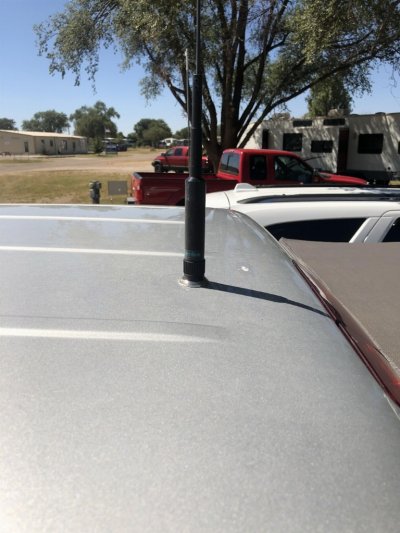

Hey guys KD5ZPN here and this is my Yaesu FT-7800 install. The RAM mount for my cell phone has since moved to the upper dash. Body of the radio is under the back seat, and I did drill a hole in the roof. I was debating getting a Breedlove Mount for the corner of the bed, but went this route instead, no leaks and works great.

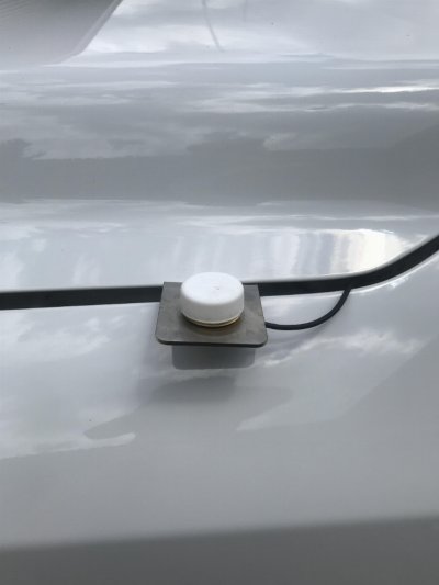

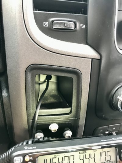

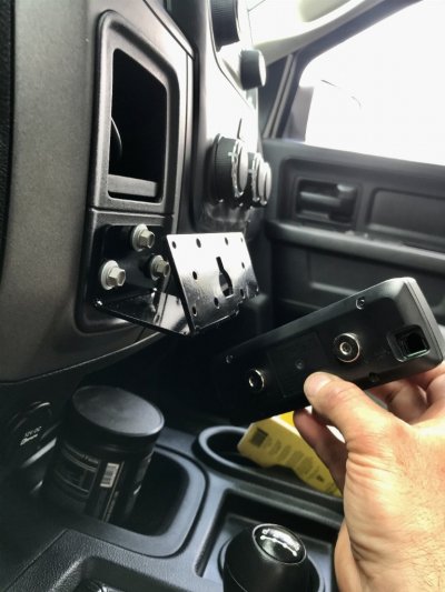

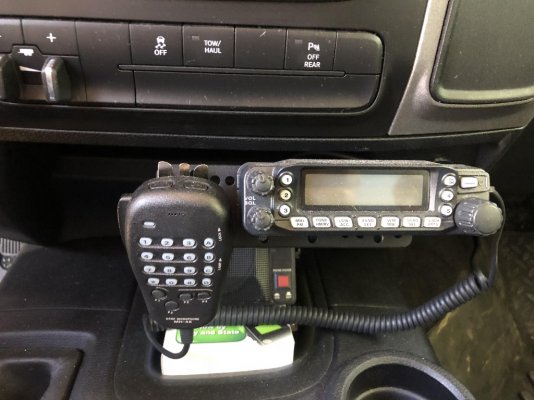

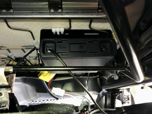

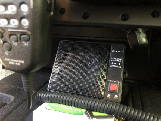

Ok.
Icom 2730A
Diamond antenna
External speaker is on order
All cords are wrapped in an abrasion protection cover.
Im a welder and im currently running the laser/break press department and doing all the blueprints for the shop.
Made a bracket to magnetically hold the head at a 45 degree angle so it is easy to see/use while driving and it is a VERY solid bracket. 11ga mild steel
Control cable for the head is run through the little cubbyhole just behind it and then under the floor center consul to the radio body that is zip tied to the bottom of the driver seat.
Antenna and power cable a run under the plastic floor under the driver seat. Then under the plastic trim on the floor in the door opening. Through the firewall ( clutch pedal delete plate. Thank you jeff)to the fender antenna bracket.
Dont forget my water bottle rain cap.[emoji16]
Shout out to my good friend and “brother” @AFMoulton for helping me with this setup. Everything I purchased and did was done with his help.
Thanks again sir!!
Sent while firmly grasping my redline lubed RAM [emoji231]

Wow. Very nice looking setup! That antenna is nice and simple looking. Been happy with the setup?
U&A
Apr 29, 2016
9,387
18,963
Michigan
2016 3500 SRW
6.4 HEMI
Thank you sir
Well it has only been operational for like a week so.....so fare i love it! But time will obviously bring out the likes and dislikes.
Ordered the external speaker today because its hard to hear with the radio body under the seat.
Want to remove The antenna bracket and put something better in between it and my fender to prevent it from rubbing. It came with some cheap foam pieces that are too small and insignificant.
Still need to RTV the hole in my clutch delete plate where the wires go through but I’m waiting a bit longer to make sure I’m OK with this set up.
