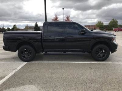

I got everything installed today. Zone UCAs, bilsteins at 2.8, and Icon springs. It is actually at 1.5" of lift when they were done. I'm interested to see if it will settle some. I suspect it will. I'll post up pictures when I get her cleaned.

I think that it provided the stance I'm going for. How's the ride?
Sent from my SM-G950U using Tapatalk
The ride is great! Better than stock springs for sure. I also have the Bilsteins back there so that could be a factor also.

looks nice, bet it rides great, the bils are a nice improvement in ride quality

Night and day difference! Even at 2.8” I guess my stock shocks were toast.
