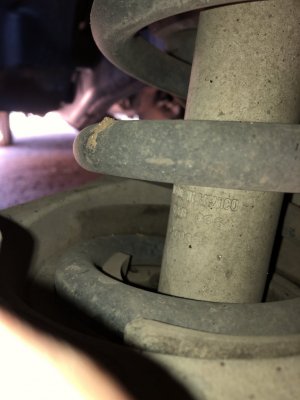

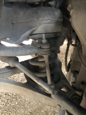

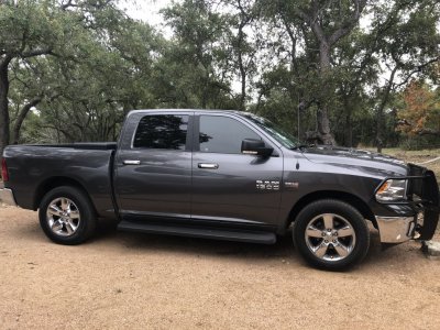

I just bought a 2018 1500 Lone Star 2wd about two weeks ago. The front shocks feel like they need to be replaced (really bouncy). They have H7006S stamped on them so I’m guessing they are skyjackers. They don’t even list those as shocks for anything past a 2012 but they are listed as being longer than the KYB Excel-G that I am looking at getting. So do I have a level kit installed on this truck? Here are some pictures. If it is leveled what should I do for front shocks? I would like an OEM ride.

Looks pretty stock to me. Measure the top of front and rear wheel well arch while parked on level ground and there should be about a 2.5" difference between them.

Difference between the two measures right at 2” difference. So I’m guessing it’s stock. I don’t think that grill guard weighs enough to bring it down from a 1” or 1.5” level. Thank you!
