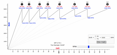

The ratios for both transmissions are below.
Aligning the ratios shows the 8-speed has better gearing down low for towing and hauling and nearly equal direct and over-drive ratios.
Both trucks are comparably equipped aside from the transmissions
6.4L Hemi / 3.73 axle ratio / 33" tires / 4x4
The attached transmission mappings are based on the ratios above and theoretical max speeds - clearly no RAM will ever see north of 160mph, but I digress...

All good information. The trans mapping is fun to look at. Still, I'm trying to understand why the 2017 could not hold 4th which is a 1:1 ratio just like the 2020 in 6th gear. Both trucks at 65 mph would have been turning 2500 rpm. However the '17 needed 3rd gear? I could understand if the 2020 dropped to 5th and the '17 had to grab 3rd. Is there that much of a reduction in parasitic losses between the 6 and 8 speeds?
Wild ass guess: the programming for the 66RFE is to save it from itself by dropping a gear and keeping fluid pumping. I don’t know a thing about the 66RFE, but the quickest way to kill a 700R4 is to lug it with a load as at low RPM not much fluid is circulating and cooling the transmission.
I suspect ZF has figured out a way to keep fluid pumping efficiently at low RPM minimizing heat build up.
