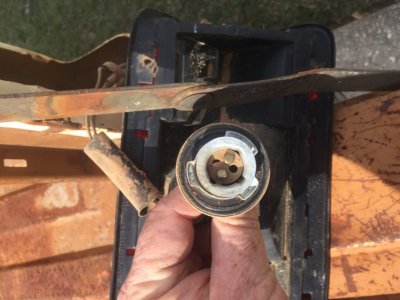

I did discover the following (see pics) the right side lower light, has a connector with dual connections whereas the left side lower light has a single connector. the 1157 bulb (dual filament) works with that double connector light on the right, but i'm not sure its correct. additionally, right side (obviously) has 3 wires coming into it, left side only 2.
Does anybody know what it is suppose to be ?

i would be looking at the ground wires where they join together. you can try running a temporary ground to them anywhere you can get a good ground. it is common for moisture to get into the ground wires where they split behind the taillights.
as far as the connector goes they most likely had a rusty socket or something and needed to replace it. i personally did that exact same thing on my truck. 1157 bulbs all around. that way i never have to keep 1156 bulbs on me for the reverse lights.
