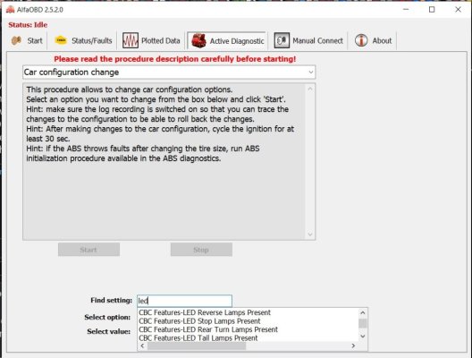

I'm surprised your having problems with the taillights if they have resistors built into them. You might want to look into buying AlfaOBD to be able to configure your lights as LED(its a very useful app that does a lot more than vehicle configuration changes).

In summary, these 3 recommendations are your best bet, AFAIC.
Remove or disconnect a resistor as a test.
Contact the supplier.
Or find someone nearby with AlfaOBD/buy your own and set the LED Tail lamps as 'Present'.

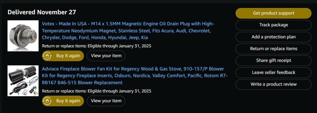

Rather than challenge yourself by calling China, you can let Amazon assist you. :cool:
Click on Returns & Orders in the upper-right corner, your recent orders should be displayed.

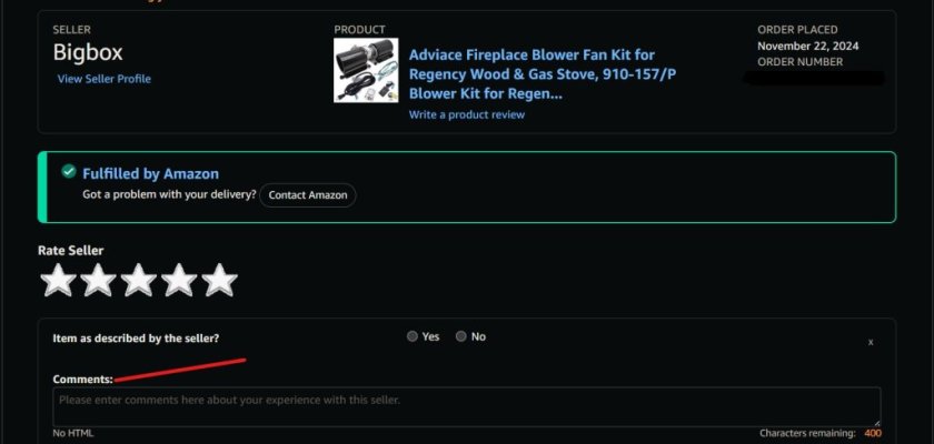

Click on 'Leave seller feedback', if there are multiple items, scroll down to the item in question. In the comments box, describe the problem and ask what they recommend trying to resolve the fault.
If it were me, I wouldn't add a rating yet, nor respond to the 'Item as described by the vendor' question. Save both of those for later, if the vendor requires more incentive to respond positively and in a helpful manner. :cool:
