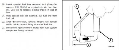

OK, I hit my first road block. Trying to get the main fuel line off from the fuel rail and my plastic fuel line tools are not cutting it. Checking back to the service manual I see a special tool is used:
Would something like this from my local pep boys work? It's 5/16" and 3/8". I want to know before I throw in the towel and have a mobile mechanic come do the rest. Thanks!

I used the plastic ones. Takes some mucking with but they do work.

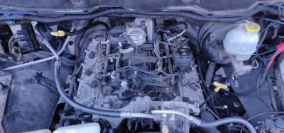

This is how far I got before the rain rolled in. I had to go slow and take my time since nothing has been apart before and the plastic connectors are brittle.

I spent most of yesterday getting my motorcycle sorted since it's got a bad battery. I took another stab at trying to get that fuel line off. Even with a friend helping we could not get it off. What's the trick here? I'm getting tired of cutting my knuckles on sharp edges trying to get this damn line off.

You are using a fuel line disconnect tool correct...? Using the proper size tool, you should be able to just slip it on the line, and push it under the lip. You should feel it kind of pop once it is all the way in, and then the line should disconnect very easily. Should slide right off. Sometimes it can be a real pain to push that tool in far enough though. Just keep wiggling, turning, and pushing until you get the right formula and it works.
Thanks.
https://www.amazon.com/Lisle-37000-...ning+and+fuel+line+tool&qid=1577201246&sr=8-1
Available at Harbor Freight also. Slip the right size tool over the line and disengage the spring that holds it on and pull the line apart.

I got it! I used the removal tool and with 2 sets of pliers, applied leverage on the fuel line fitting. After I got the line off the issue was immediately visible. One of the metal tabs inside the female fitting was bent outward the wrong way. I was able to fix the tab after getting it off.

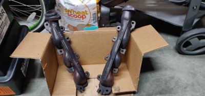

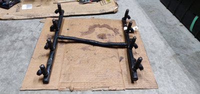

More - slow - progress. I only have about 45 minutes to an hour some nights so I do the best I can. Got the exhaust manifolds off and hit them with rustoleum catalyst. Also got new fuel injectors and the rails cleaned up.
