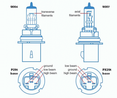

I bought some new specd halos and got em all wired up and was installing them on the truck when I noticed the wiring harness on the truck has a red wire and 2 purple wires. This wouldn't be a problem but I can't find my dads voltmeter to see which is which and he's overseas right now. Does anybody know which wire is which?

Well, red is your hot wire and one of the two purples is your high beam wire....so without a volt meter it's gonna be tough, however:
Maybe this will help?

Perfect. That's exactly what I was kinda looking for. Couldn't find the sob anywhere else, now just gotta look at it after school lol
