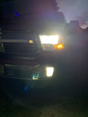

I just installed VLEDS micro 5K / 3500lm LED bulbs in my low beams (and matching fog lights). The bulb plus wires fit perfect behind the dust covers. They are a huge improvement over the OEM bulbs (I had Sylvania Silver-star ZX bulbs prior). Going to add 6K / 4800lm high beams next. Love them!
