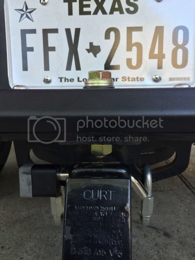

So I managed to fix the rest of the flex. Getting it welded helped a lot. Nothing but a good ole 5/8 x 4 grade 8 bolt.
Before
After
And no more flex at all

I know it may not look the best, but when I'm not towing I can easily remove that bolt.

That's not a good mod, 2 pin holes.
That would make me take it off and replace with new.

You sure that's a factory hitch ?
Mine doesn't have 2 holes for the pin, and the top bracket that goes under the bumper is different. The top plate on mine is hard against the bumper, not spaced away like yours is.
I would take the 2 outer bolts down thru the bracket also.
Do you have a stock bumper or aftermarket ?

I'd don't believe I've ever seen a hitch manufactured with 2 hitch pin holes. That to me is someone's tampering to get tailgate clearance on a tongue Jack. The wrong way to accomplish it if that's what was done.

Oh the two alan head bolts are part of the mounting for the rear bumper I have. It came with the Magnum bumper. I've thought about drilling the bracket out to make those two go through it though.
If it's not the stock one then at some point it was replaced with one that is very similar. On my build sheet I have the trailer brake package and 7-pin wiring with the receiver hitch.

My '10 and/or my '12 had the 2 different holes for the hitch pin. Both trucks had the factory hitch installed when built.

So I googled it. There is a reason for 2 holes but one should be smaller diameter for a "j" hook anti rattle.
I never seen it before. I can see if the j is used it would be safe. I wouldn't use the outside hole as a regular hitch pin hole. If I had it I'd always use the j pin.
I currently have a 12 with factory tow no second hole.

ya I've never used or even payed attention to the second hole. All I know is at some point if I have trouble with this again, I'm going to be replacing the hitch completely

Yea, that doesn't look like the factory hit to me. Probably an aftermarket unit made to be similar.
