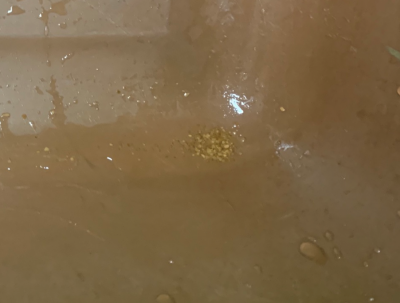

I flushed the heater core about 20 times about a 2 gallons each time into a bucket and flakes of junk every time. my heater is working better still a not that warm on the drivers side. 2014 2500 6.4 105000 miles
