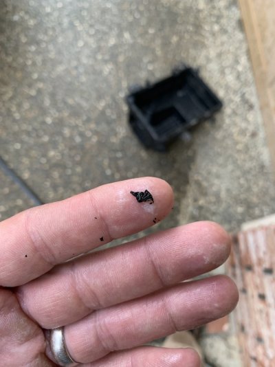

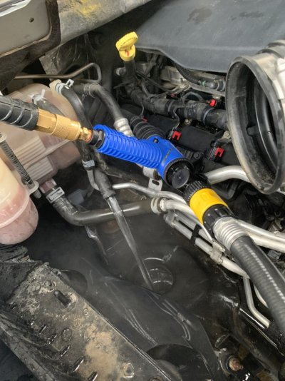

IMG_4236.jpegIMG_4233.jpegIMG_4226.jpegIMG_4230.jpegIMG_4232.jpegIMG_4229.jpegFinally got around to flushing my heater core. Was having really poor heating performance, especially on driver’s side.
Flushed both directions with hot water from sink— 120 degrees for 1.5 hour. I bought the gun that allows you to inject air along with the water. Switched back
And forth 10 times each way, let my compressor build to 30 psi and flushed and pumped the air to it— each direction 10-12 minutes. Would give it short 1/2 second bursts, and then when the compressor would get down below 10 psi give it 3-4 second bursts. Don’t even bother doing this exercise without the air assist, the only time it produced the sediment was during the air injection.
Glassy orange flakes, glassy black flakes, orange “dust” is what I found. See pics. The black flakes were quite a surprise, looks like carbon.

Saw one of the hoses from heater core goes into the oil filter cooler, maybe that black carbon comes from the oil cooler? Or possibly some carbon bleed by the head gasket?
