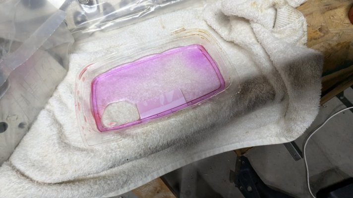

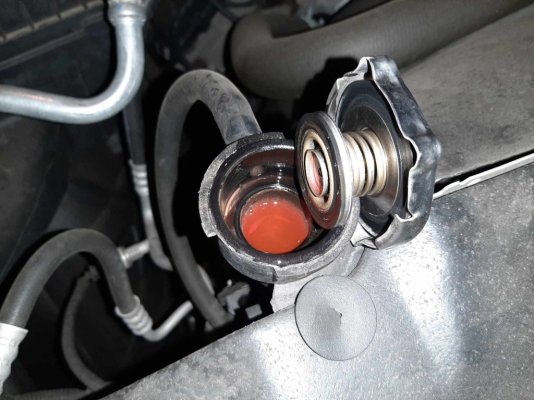

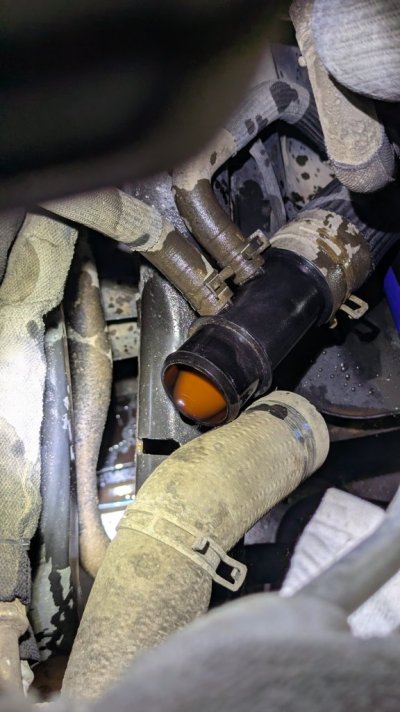

I’m working on my 2021 Ram 3500 6.4 HEMI, and during a tune-up I accidentally broke the plastic radiator neck with my knee. That’s what led me to pull a coolant sample, and now I’m trying to confirm whether the coolant in this truck is actually the correct Mopar purple OAT and used or something else.
The truck had the heater core replaced about 8,000 miles ago at a Canadian Dodge dealership, and I’m not familiar with whether Canadian dealers ever use a different color OAT. That’s what I’m trying to figure out before I go through the work of flushing the entire system (which I’d really like to avoid if it’s unnecessary).
Here’s what’s confusing me:

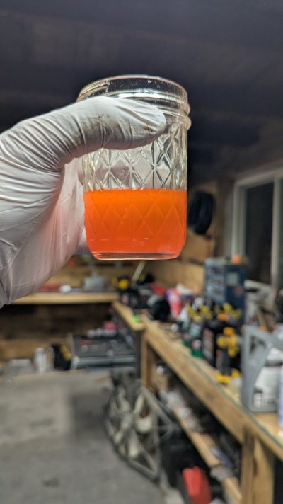

In a jar under bright light the coolant looks or orangeish.

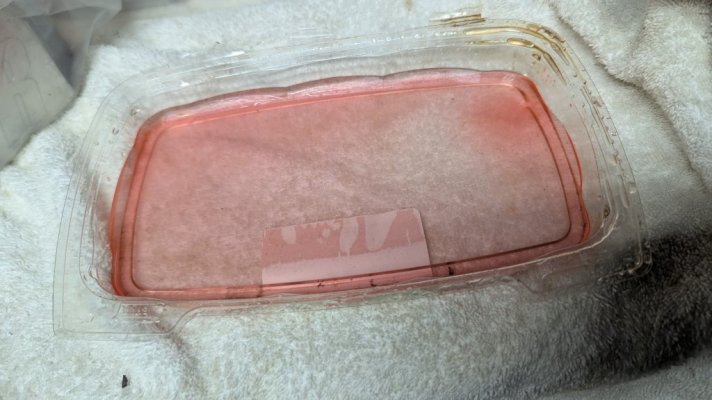

On a paper towel it comes out pink or coral colored.

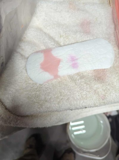

The brand-new Mopar 10-Year OAT I bought is obviously purple. I put a spot of this on a **** pad along with the one that was in the truck. You can see a side-by-side comparison in color.

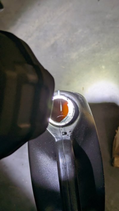

Also, it should be noted which I've also included a picture of the purple coolant in the little tray is brand new from the dealership but also looks orange when it's in the 1 gallon jug which I also took a picture of.
In a glass jar I mixed the truck coolant with fresh Mopar OAT, and also mixed some yellow universal HOAT with the same Mopar OAT as a control sample. The results were similar enough that I can’t confidently say whether the coolant in the truck is pure OAT or if it was cross-contaminated at some point.
I still don't have the new radiator in as I'm waiting on hoses. Before I flush everything, I’m hoping for input from 5th-gen Ram techs or anyone who has dealt directly with OAT vs HOAT behavior in these engines.

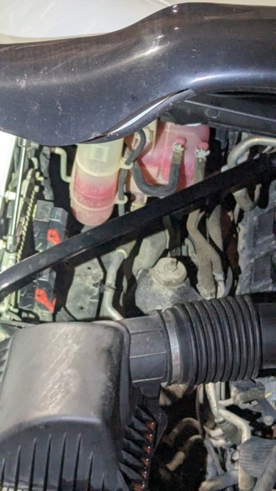

And my coolant reservoir is stained pink

My 4th gen 2014 5.7L (can we count the differences) has a coolant reservoir that is stained pink/orange, my factory fill was replaced at the dealer about a year ago, using Mopar coolant, and it is the same orange you show at your break. I have been told the coolant is supposed to be purple out of the bottle and turns orange very quickly once in your system and used. See pic below, taken months ago for a different reason.
I don't know what to tell you about the coolant you have that is orange in the bottle. No experience with that. Basically your post went unanswered for about an hour, so this is a bit of a bump, again, see pic. Good luck.

It uses OAT,and it doesn't matter if it's a Canuck or US truck.Ma Mopar doesn't have differant coloured coolant for differant countries,lol.That's about the right colour for OAT coolant after it's been in use for a bit.
Just for the record the only real differances between a Canuck and US truck are the daytime running lights will be enabled on a Canuck truck,and the speedometer will be in kilometers per hour instead of miles per hour.
Other then that the trucks are pretty well identical

Thanks for your input. The one in the jug is the purple one when it's in the clear container but in the jug it shows as orange. Just like the one in the truck. Shows pink and a clear container but orange in the truck lol. Confusing

The 6.4's are famous for plugging the heater core,and it wouldn't hurt to flush it ,as it sounds like it's already had 1 heater core replacement,so you might be wise to flush the engine and heater core,then look into installing a coolant filter.
Go down into the 4th Gen HD section,and you'll find a few threads on their cooling system issues, one of the fixes is flushing the system and installing a coolant filter inline with the heater hoses

The color changes with temperature, from pink to purple and orange. No HOAT anymore for over a decade. Run rmi25 if you want to see if you have casting sand.

I guess my concern was it's very similarly colored to the hoat I went to my dealership and got a gallon of it just to compare and it's also pink in color once ona pad. I was able to call the dealership and they gave me a part number in Canada which is a OAT coolant and that's what they said they used so hopefully they did. You seem pretty knowledgeable. How should I go about flushing the system. I currently don't have the new radiator in yet. Thoughts?
