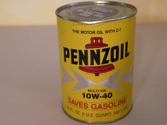

On my Grand Fathers Dairy Farm, we were still buying Motor Oil in Glass Jars, a lid had to be removed & a funnel was then twisted on, i think we used Pennzoil.
After that, we switched to Cardboard oil containers, they always leaked
