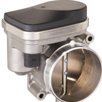

Yep, it is on the side of the throttle body. Did a new one come with the new throttle body or did you use your old one? Also, what about the map sensor and idle air control motor? Did you replace those (or get new ones on the new throttle body) or did you use the old ones?
I didn’t replace the MAP sensor. The TB looks like the one below. The black portion is off to the drivers side and the pictured opening faces forward to the back of the radiator. The 6 pin connection is in good shape.

Yeah, sorry - I grabbed a pic of the 5.9 TB, not the 5.7.

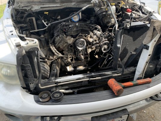

Another update to the lost idle. I was doing a break job and shocks and noticed the vacuum tubes along the drivers side of the engine that connect to the solenoid under the battery had kinked/twisted. I'm sure I did that when I was rebuilding the motor and putting it back in. anyway it was likely a vacuum leak. This seemed to help my shifting issue more than the idle issue. Now, when the APPS arrives I'll put that in and hopefully get more than 8 mpg. Think I need to recalibrate the APPS after installation. Will post again in a week or so when this is changed out.
