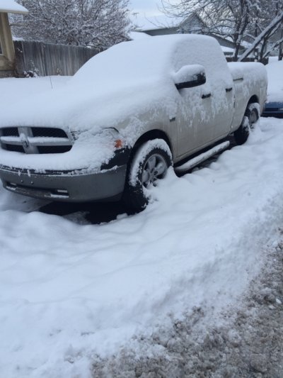

Please tell me how to do that and I'll try anything. Just keep my current weather conditions in mind lol a55b125e38dc1ec6f67818c3b3f91135.jpg

Well... better bundle up and grab a shovel. You gotta get under the truck to access the harness. There are 4 pins that run the pump, when you look at it the pins are 4,3,2,1 you are going to be using 4 & 1, 1 = hot, 2 = ground. I grabbed some alligator clip jumper wires from Harbor Freight, since the pins are flat you can clamp onto, on the other end of the jumper is another clip, just run you some 18G wire up the the battery and connect to the posts. Your pump should come right on, I found out that mine was intermittent by just touching the "hot" lead to the battery several times as you would turn the key on and off.
