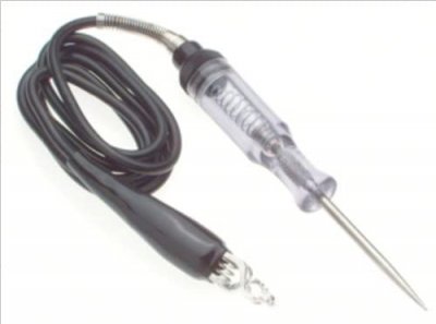

try using a circuit tester in the harness plug with the light unplugged to see if you are indeed getting 'juice' at all to that driver's side light...
Then try it in the harness itself... you might find if you have that "break" in a wire
Ok so i found that there IS juice to the light...but only when i use the ground on the tester. Im assuming that means that there is a problem with the ground wire for the harness itself?
That can be answered buy rigging a pin out of the ground on the harness and clamp the tester ground to that pin to complete the same circuit the bulb would
