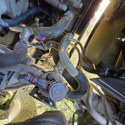

Hey yall,
I'm about to start my rebuild and I realized i haven't purchased 3 small hoses that I'm having a hard time identifying. I looked on rockauto and identified one of them (i think) and they were out of stock. Just trying to find some part numbers so I can then try and find the parts. lol. Picture attached. Thanks for any help.

hell that's not a bad idea really.
Another option is to convert the truck to the molded hoses for a 5 or 6 speed truck,and delete the ones feeding the thermal management unit on the side of the transmission. They did away with the 3 way valve somewhere around MY16 if i remember right,so you're looking for hoses that they only used for a few years,that's if you want to keep the 3 way valve and use factory molded hoses. Where you are heater output probably isn't a big deal,but when i converted my 14 back to the earlier 6 speed molded hoses,i did notice better heat from the heater,as all the coolant goes to the heater core with the earlier style heater hose set-up. I just left the 3 way valve in place with the electrical connector still hooked to it,and never had any check engine lights or codes.
