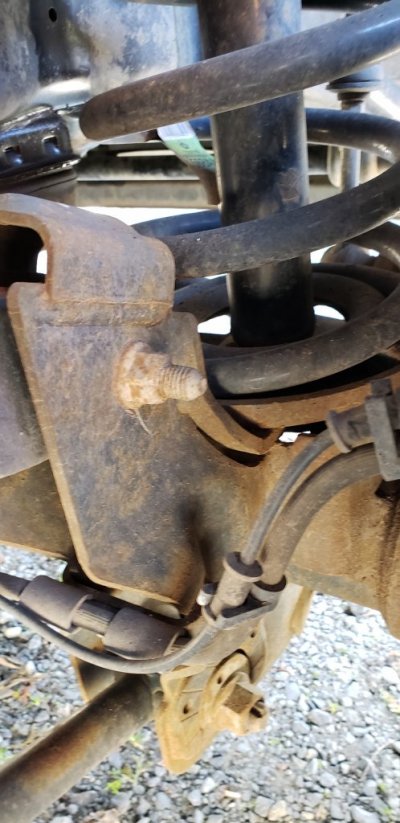

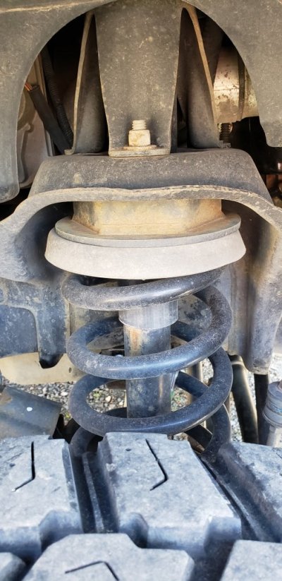

Hi all, new here, and also don't know much about lifting/leveling. Bought a truck that has quite a few mods - 2012, 2500 diesel.
Can anyone help me with determining if there is a lift of any kind from the attached photos? It est I can tell, it looks like it's leveled, but not lifted?
Thanks!

Looks like a leveling kit in the front the air bags are just helper springs youll want to keep around 8psi in them when you're not hauling. If I had to guess I think its a 2" level in the front. Its been a while since Ive had the older style trucks in

Yep looks like a 2” or 2.5” level. If you really care, just measure the total height of that steel front spacer over the coil spring, and that is the amount it was raised.
