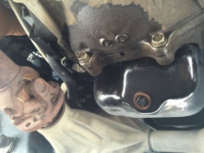

I noticed some oil under my truck so I climbed under and I found some oil dripping from around where the transmission and engine meet right behind my oil pan and drain plug. My best guess is it is leaking from my rear main seal. Do you guys think thats right or could it be something else?

Rear main guaranteed

It could always be something else but safe money is on rear main. How many miles are on your truck? You could try running high mileage oil As there are additives that are suppose to make seals swell some and hopefully slow your leak down or seal it up completely.

As others have said, its most likely the rear main seal. Look on top of the bell housing if you can see it. If oil is there its possible its leaking from he lifter galley. Not even sure this is still possible, I'm used to working on much older stuff...

Is it definitely oil or is it trans fluid? I had a trans leak that looked very similar to this and it turned out to be the pump seal behind the torque converter...

My trans fluid isn't getting lower but my oil is that's what is leading me to believe it's a rear main leak.

Yeah my trans fluid wasn't getting lower either but if your oil is then I'd say you're right....

It sure is my rear main. Thanks for all the input.
