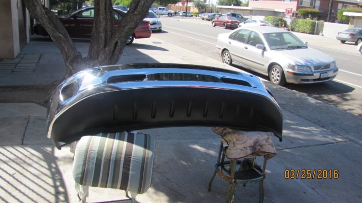

My 2016 Ram came with a stationary air dam below my chrome bumper
I understand that newer ones may have a movable air dam below the chrome bumper
