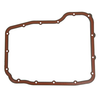

Best RFE transmission gasket is Lubelocker LLT-CRFE (no sealant/RTV needed)

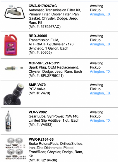

So I was wrong. I just looked at my Summit recite sorry. Its C-ATF... Sorry I am on very little sleep.

read all info posted, it is for your transmission. It is much easier to drop and service your transmission then the 8 speed, by magnitudes.
