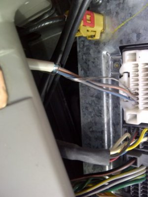

Double check the pinouts on the radio connector, I fought with this also and took a pic when I had it working. If I remember correctly, pin #1 actually wasn't the first small slot. This is a shot looking down at the back of the radio, (turn it clockwise 90 degrees for the original angle i took it from). If you need to move it, the white plastic harness plug has a locking tab that is removed by simply lifting it up and out of the plug. (not as easy as it sounds). Wires can then be pulled back out of their cavity

You fought with which part? The no back up cam part or the no reverse lights part?
Yep, I checked those about 6 times also. No continuity between conductors and they're correctly landed in pins 3, 4, 5 as identified on both the connector and the C1 port in the radio.

My apologies for not being clear, I fought with the no backup cam part - never did check the reverse lights. Good luck tracing this down
