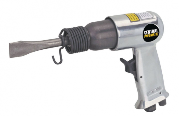

a nice 12pt socket will sometimes do the trick, hammer it on and slowly carefully rotate it by hand with a breaker bar. Else, use a chisel hammer. So many would come into the shop in your same situation.
