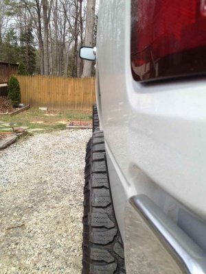

-12 offset with 315/70 17's which equal out to 34.4x12.7

I have seen a lot of pics with -12mm offset. They stick out around 2". Would a 0mm offset stick out around 1" with 35x12.50 20?
1'' is about 26mm if I remember correctly. So if your stock wheels are +19, and you drop down to 0mm offset, that is right at 3/4''. Then add the width of the tire of a 12.50, is about 1.5'' wider than stock. Split that width and that is what you should have sticking out. 3/4''(rim) + 3/4''(tire) = 1.5". So on paper it should be about 1.5'', but all tires a slightly different so you could say in the range of 1.25'' to 1.75''. If the -12 sticks out 2'', then take the 12mm it takes to get back to a 0 offset, which is right at 1/2''. Wheew! lol. That is the way it was explained to me and you can figure just about any tire and wheel setup using that info.
