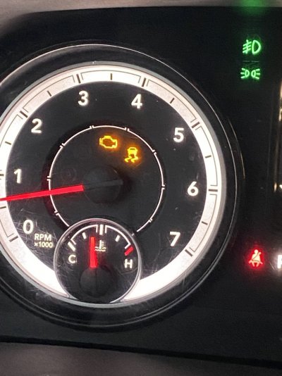

So this just happened need some advice on what I should do it’s happened before when I first got the truck and it stopped. Any information on what I should do is greatly appreciated

EVAP Purge
|P0441 DODGE code possible causes
EVAP purge solenoid vacuum supply
EVAP purge hose/tube obstruction
EVAP purge solenoid vacuum supply-evap system leak
Faulty Powertrain Control Module (PCM) < ------ i would forget this one
Read more: https://www.autocodes.com/p0441_dodge.html
Don't toss away old parts, until you know that it was the issue

This sometimes go away, clear it and see if it reappears. Mine did it once in 10 years, never seen it again knock wood.

Check your gas cap O-ring for any cracks or missing chunks. Also check to see if any rust on sealing surface. Daughters boyfriend's 2012 Jeep with hemi had rust on sealing surface, hit it with some fine sand paper and light coat of grease, no codes yet 6 months later.
