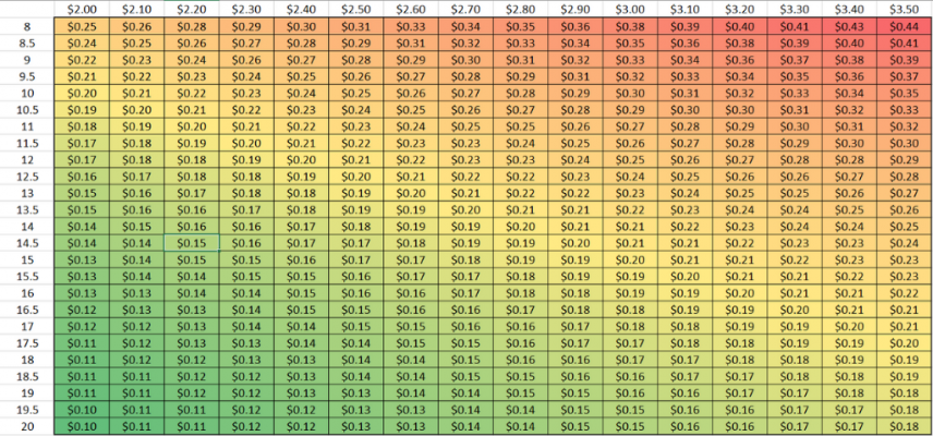

I will share this again for those who want to know if running 89 is worth it to them. The top is the cost per gallon and the left is the miles per gallon.
As you can see, in most cases if you achieve at least a 1 mpg increase with 89 octane, then it would make up for a $.20 to $.25 cost per gallon difference of 89 octane because the cost per mile will be the same. So you are getting added performance and knock prevention for little no additional cost. Basic rule of thumb, for every $.10 increase in cost, you need to achieve an additional .5 mpg for the cost per mile to be the same.
Of course it is a different story if your mpg does not increase.
